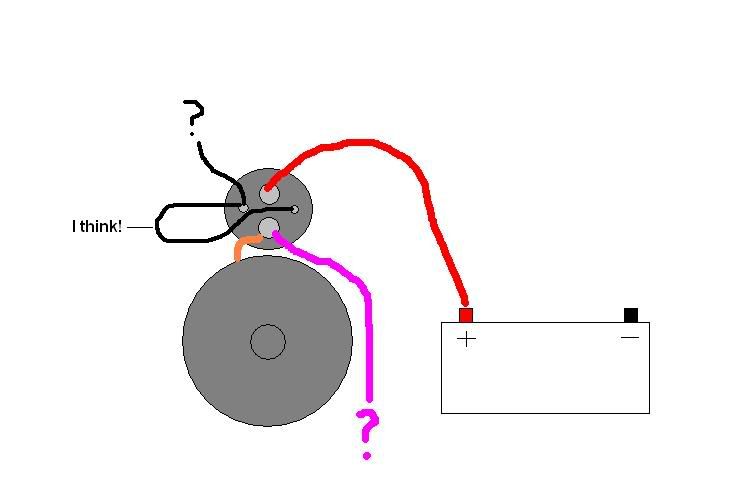

what I have (from memory)
The "pink" wire (which comes from the alternator) in your diagram needs to be connected to the same terminal as the "red" wire in your diagram.

Ah, ok, my only concern is that im 99% sure it wasnt together before (ie the old starter had the wires as pictured)  :)

There should never be anything else connected to the starter motor side of the solenoid. As said, alternator has to connect to the same terminal as the battery.

Well I bow down and humbley apologise, wacked them both on the top post and problem solved!
What a pleb! lol Ive changed loads of starters before, oh well, live and learn, cheers guys :)  :y
