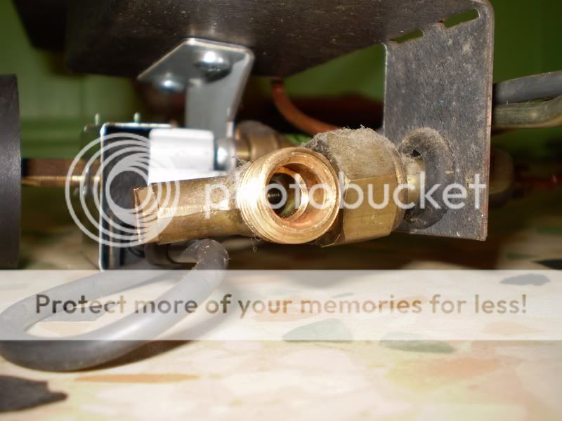

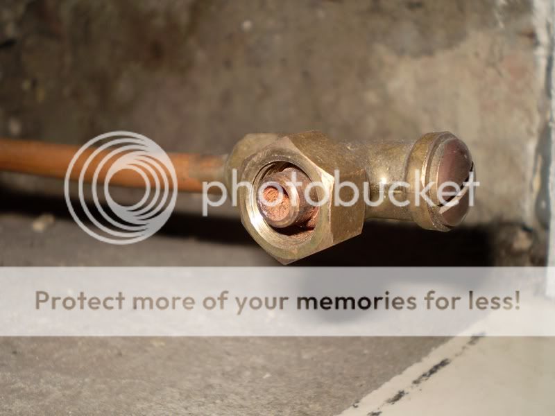

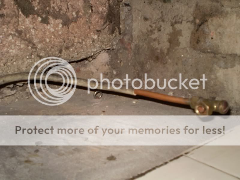

Do all gas fires come with the same size fittings?
We need a new gas fire, preferably one that will fit the existing pipework.
Main supply takes a 17mm spanner.  :y
