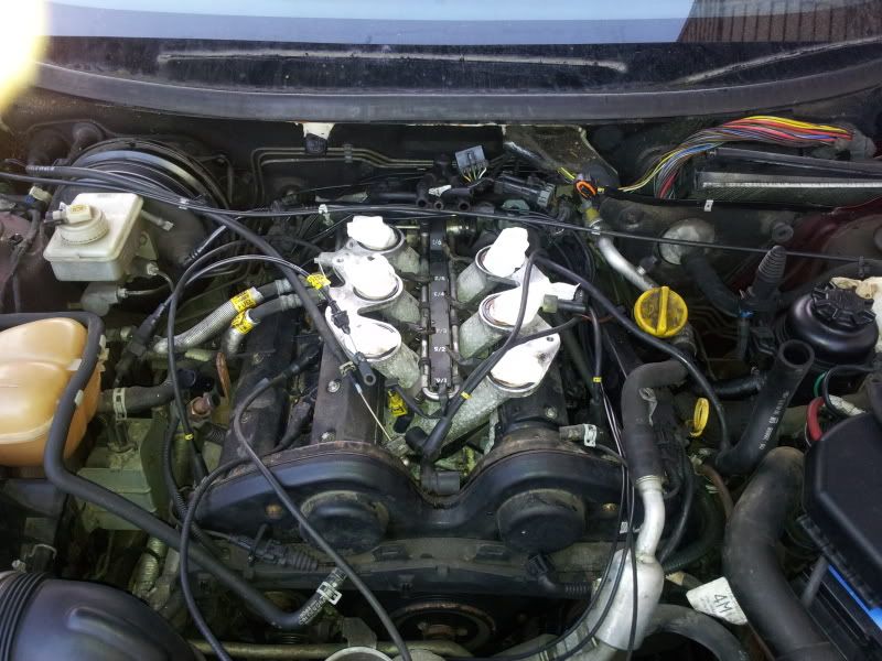

She fired up easily enough after all that time sat dormant, but had developed a mis-fire.  My friend also mentioned the car having a water leak somewhere but he had'nt figured out where, so after a dig through the internet and finding the buyers guide on here I started suspecting the HBV leading to DIS pack failure.  Other than that It'll need one tyre replacing as it sat flat for too long.
So... today I started work.
This is my first time doing much on a V6 so I'll be going slowly.  The HT leads are going to need re-routing when I'm done I think.
The DIS pack has been removed - not as bad a job as I'd feared TBH, and the HBV has been replaced.  The DIS was mounted horizontally to the back of the block - is there an easy(ish) way to remount this somewhere easier?
The replacement DIS is arriving in the morning so I'll get cracking on it tomorrow, hopefully we'll see it running.
Looking down at the front of the V...
Is that bit of corrosion down there a cause for concern?
More questions will follow... prob'ly!

Well she's running... for now.
It turned out the DIS my mate bought over was the wrong one (shocking eh?) - so we temporarily  fitted it anyway in order to get the engine running and troubleshoot where necessary.
We made up a bracket and mounted the DIS next to the cruise control unit just under the air box. There's a handy cout out on the bottom of the airbox that could have been made to measure!
In order to get it running we made up a loom to extend the wiring around the engine bay - it's a bit of a bodge but it means the car can run without cutting or modifying the loom, although the O/S HT leads have to go over the top of the engine.
With that done the car runs sweetly and with the new HBV fitted no water leaks were found.

The corrosion looks like a possible leaking stat or cooler plate to me. :-\

I'll be keeping an eye on that corrosion.
Apparently the car has had the heat exchanger replaced so I'm hoping that it's just a remnant of the original problem.
