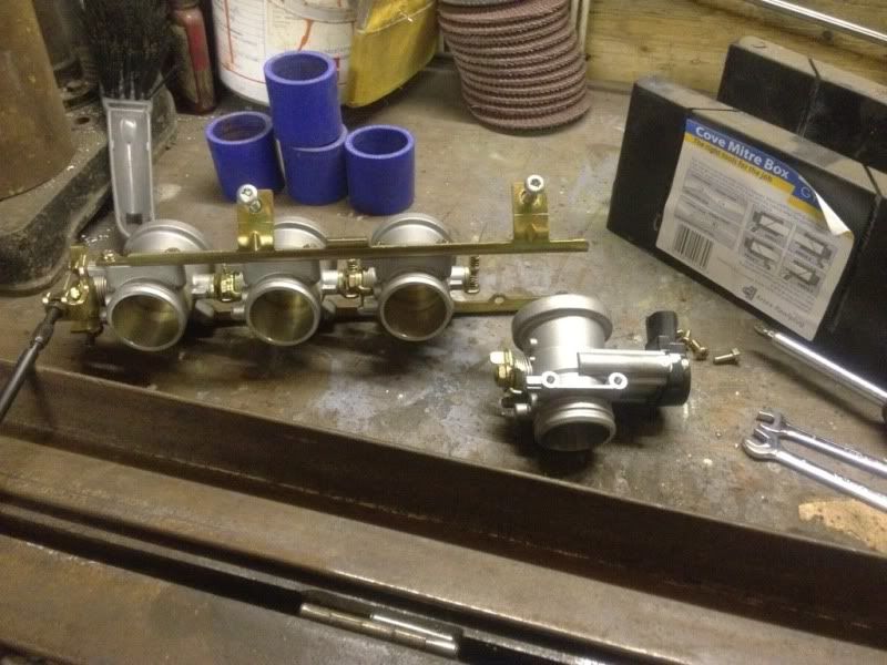

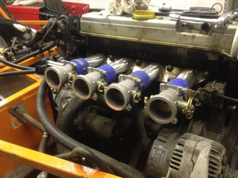

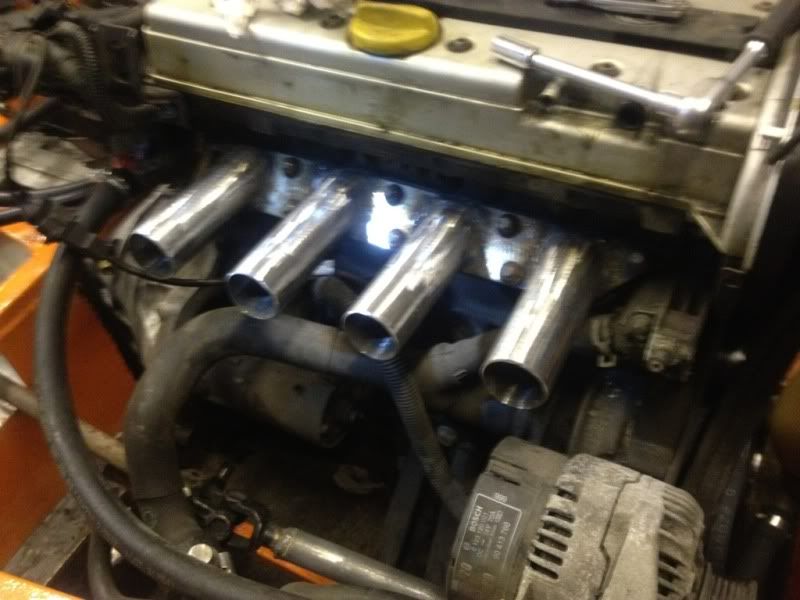

well after alot of head scratching ive decided to bin the whole lot and just nick the bits i need to run mega squirt and seeing as im fitting the megasquirt i decided to upgrade the intake system
38mm motorcycle throttle bodies home made manifold should improve things a little  :y
