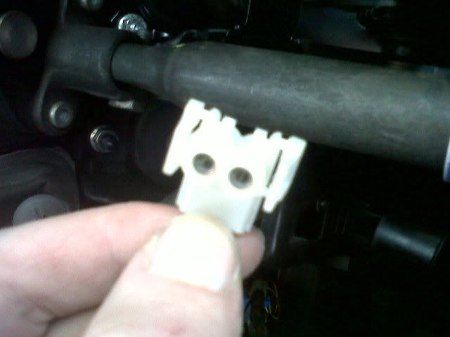

I went out and purchased a cruise stalk, wired up and and activated it but it wont work.
Checked that i have a clutch switch and it seems i don't  :'(
I have a 2000 'X' 2.2 (Z22XE) GLS Estate
Can any one advise if i need a switch and if the plug i have found is correct.
Also i only have 1 brake switch. Is this correct?
I have taken some pictures of what i found:
Spare plug i found taped up:
Is this where the clutch switch should go?:
Any help/Advice appreciated!  :y

Ok, Having had a quick flick through the how to it looks like i need the clutch switch  :y
That's going off the guide for pre-facelift but the plugs for the clutch looks like the same one.
Any one confirm that the clutch switch should go where that black gromit is in the pic above?

a manual with cruise needs a clutch switch for two reasons - it will not work with out because the cruise module/software expects a closed circuit between the two terminals on the clutch switch plug ( the auto box bridges these out) and without it ( if you bodge it) you'll find one day that you press the clutch with the cruise engaged and it will just over rev.
so here's what I'd do.
check whether I had 2 or 4 pin brake switch: if two pin then order both the brake and clutch switch.  If it is a 4 pin brake switch then you just need the clutch
when these are in place, you need the cruise software enabled - that requires tech 2
