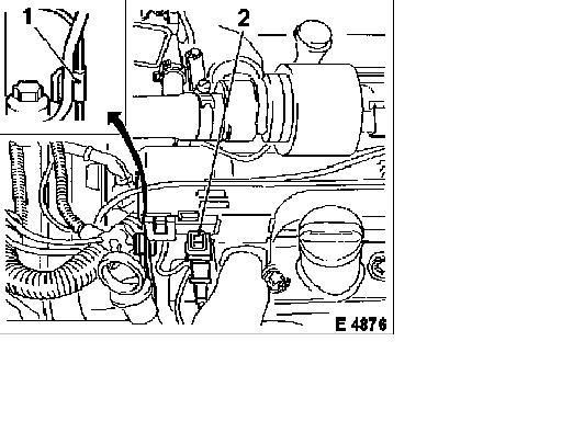

You`ve trapped and possibly damaged the knock sensor cable (screened co-ax) on passenger side, or dislodged the connector.
Courtesy of MDTM
The connector for the knock sensor is indicated by No 2 and the wire clips and runs as shown by No 1

Whoops!!!  :-[ :-[ :-[ must have not plugged it home firmly enough. Alls well again now, thanks guys  :y
