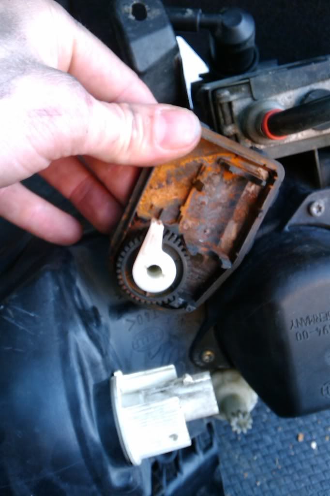

Hi, I'm going to replace leveling motors in an hour now, but there is a problem.
Lights level is now adjusted manualy (motors dissconected, "threded sprocket" inside the box turned by hand), when replacing box with motor, will light beam fall down to the lowest point or will it stay up? I don't really know what it looks like inside but will soon see...

...and how can I take out existing leveling motor?
Should I pull it out, rotate or do I need to disassemble headlight?

One done, one more to go
