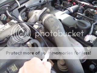

Oil cooler . Found something that is a cooler of some description but probably just the turbo. Have taken a photo and posted on a Peugeot forum. Here it is
Pressure tester? What is it and where do you put it please? Is this the spare water expansion cap adapted and pressurise with a foot pump?

« Reply #4 on: 17 June 2012, 16:36:55 »
Its not unknown for that cooler under the oil filter to fail on the pug engine so its quite possible yours is gone

« Reply #5 on: 17 June 2012, 18:40:01 »
agree with this!! :y
