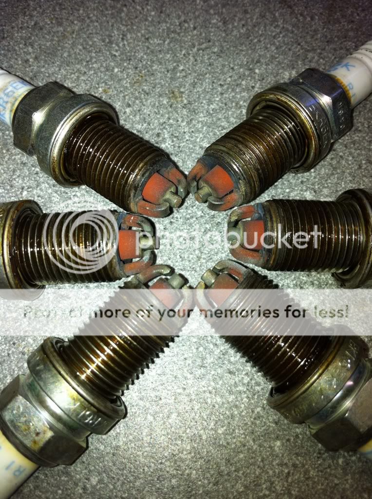

Changed MATTmv6's spark Plugs for him on weds, and I was suprised to see the combustion coating that's normally on omega plugs had a red/terracotta colour to it.
All 6 plugs exactly the same. A quick google reveals a few forum threads suggesting fuel additives to be the cause. Matt uses super uncleared as a rule. But that's all.
Anything to worry about? Car has 3.0litre cams in its 2.5v6 engine, and RR shows 215bhp.
I'll post a pic later when I get a chance. :)

Its signs of them using MMT in the fuel (cant recall the chemical that is MMT but it has Manganese in it), this is an anti knock additive, probably more likely to find this in super unleaded's than normal unleaded.
Nothing to worry about.

Pic. Just for the record. :)
No wonder you can't recall it,Methylcyclopentadienyl manganese tricarbonyl, wouldn't want to spell it either ???
