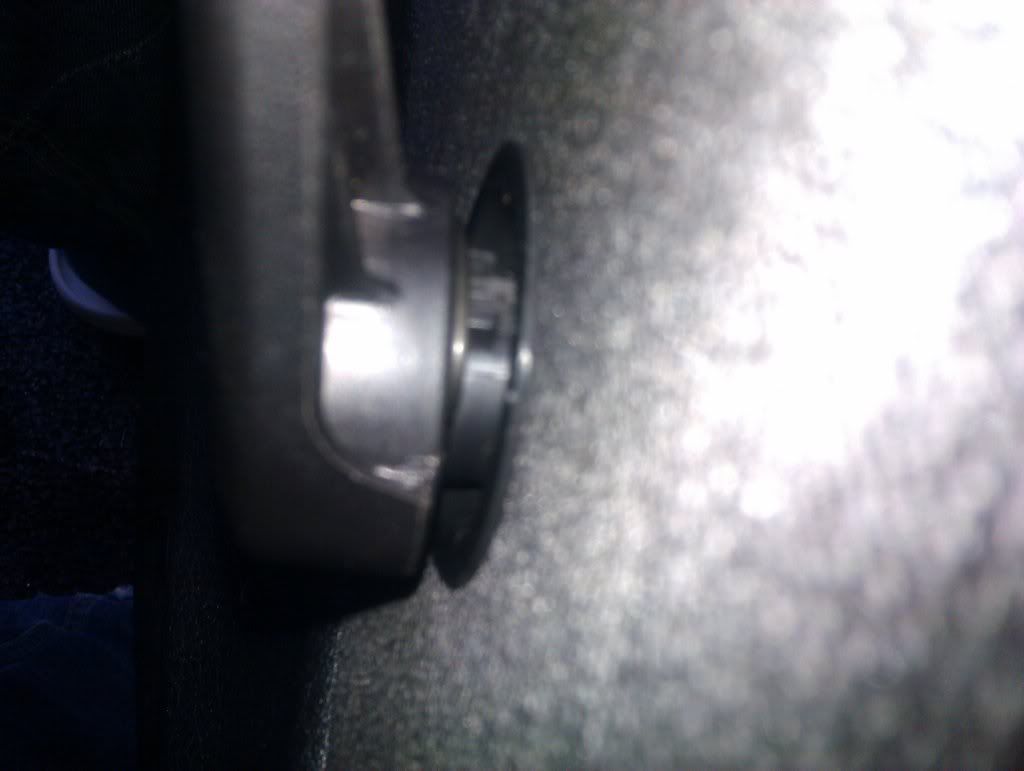

« Reply #5 on: 14 July 2012, 11:22:11 »
Not a very good pic but you can just make out the clip. Handle need pulling towards you as far as possible

Thanks Rob,
                    presume clip is the narrow black line next to the winder  in the photo? (that looks like a rubber 'O' ring )
Cant see that on this one  . . . but going to have another good look  :y :y

« Reply #8 on: 14 July 2012, 12:12:41 »
yep ... sussed it now  . .. but can't get on it for a while  . . piddling down here again in Saffend ::) ::) ::)
