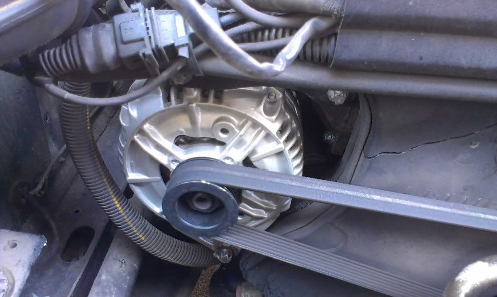

Thanks guys, in fact...it's not Bosch but some rubish Delco fitted.... Been quoted 150E for Bosch 120A today with hands I'll probably go for it now.

So...150e later omega has new alternator fitted, Bosch - much bigger than before
Old alternator had melted soldered contacts (!) couldn't believe my eyes. The electrician said that it's common for those Delcos to have an overheating problems but I never thought it could melt anything.
I hope the fault is fixed for now, thank you guys for all your help  :y
