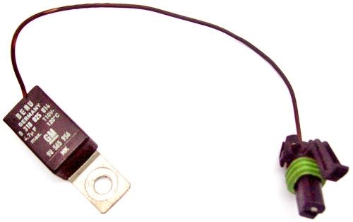

Suppressor only fitted to 2.6 & 3.2 in the UK. May be different for the States. Normally bolted to the loom earthing point at rear of N/S head. Connector is near the loom for Dis/coilpack

What can happen if I run engine w/o it? What is N/S head? head with 2,4,6 cylinders?
I just called Cadillac dealer, they cannot find it. Do you know part number? It is not clear on your picture. Maybe it was not there and I am chasing a ghost.:)

90565956

Send Andy C a pm if you need one sent over :y He's a friendly Parts Manager at a main dealer :y
The wire from it connects directly to the main power feed from the ECU to the coil pack(s). if it has come loose, I might make contact with an earthed part. The resulting fire would not be pretty. Disconnecting it makes no odds to how the car runs (it reduces electrical interference of the radio), but be sure to isolate it properly within the loom :y

I had to replace the one on my 3.2 because the wire had corroded were it enters the box. Dealer was only able to source the one fitted to the 2.6 Vectra B . Same plug, but no wire. :y
