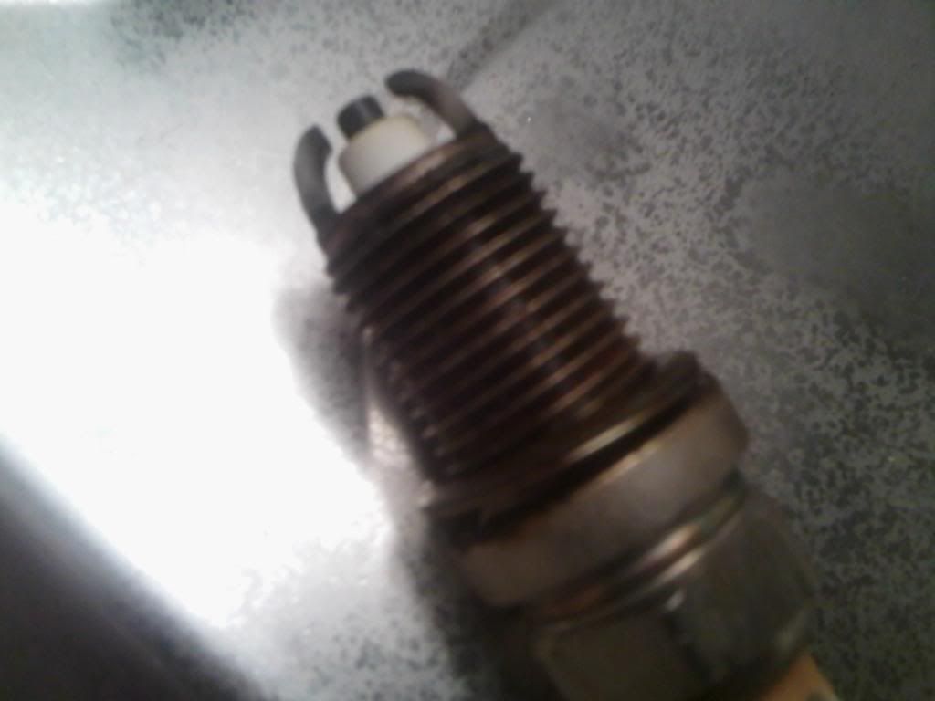

Hi guys,
As above, broke out the compression test kit tonight  8) only PITA was getting those violet relays out for the pump and injectors  :( stuck solid they were... but I don't give up that easy  8) ::) Even managed to get to pot 6 with no problem :):)
Anyway ::)...
Dry test results:
Pot 1 - 215psi
Pot 2 - 210psi
Pot 3 - 210psi
Pot 4 - 215psi
Pot 5 - 205psi
Pot 6 - 210psi
SADLY I went to do the wet test, just for completeness......................and i've not got any oil lol  :'( what a mistaker to maker  ::)
But what do we think of the results.... i'd say they were pretty good and definitely a good consistency.
ps, car had been on a run today and all spark plugs looked the same.....
