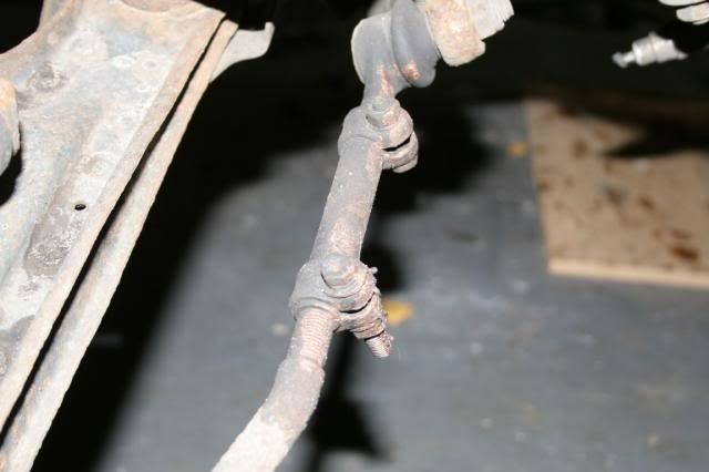

I recently had my front wheel alignment done but now my steering wheel is not quite in the straight ahead position when I'm driving straight. So I thought I would adjust left and right track rods by exactly the same amount to bring the steering wheel back to centre. This is what the setup on one side looks like.
There is a ball joint and rod at each end and a sleeve in the middle. If I slacken each of the two bolts so that I can turn the sleeve, surely all that will happen is the sleeve will unscrew from one ball joint rod and onto the other ball joint rod with a net result of no change to wheel alignment. What am I missing? Just how is it supposed to adjust please?
one side is a standard right hand thread, t'other side is a left hand thread  :y  :y  :y
but I wouldn't do what you're suggesting, the theory is right, but in reality you need to take it back to get them to re-do it.  :y :y

Did they adjust the rear track rods? Because if the front is set correctly, then it will be the rear that's driving out sideways, which the driver then has to correct with the steering. Rear thrust angle needs to be correct. Ie straight ahead. If its not, effectively you have a crabbing car, and ..... An off centre steering wheel.
And as Andy says, it rarely works that way. It needs measuring. Accurately.
