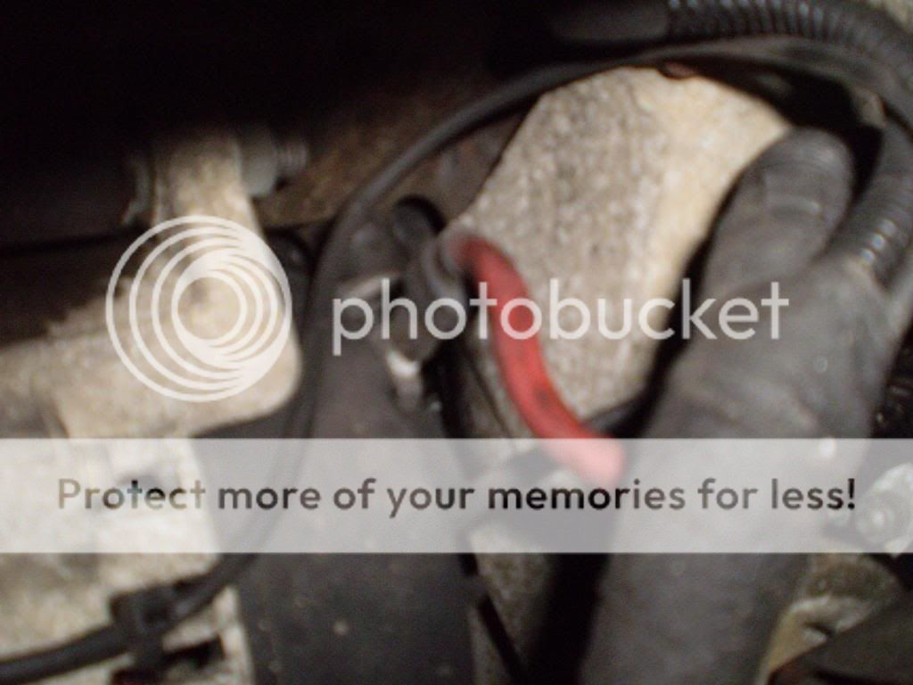

got access underneath to the heavy red cable going to the alternator and when i connect the charger the powersounder starts up,presumably this is ok and if so how long will it sound for.
John.

... and if so how long will it sound for.
till you turn the key in the ignition .................  & a bit  ;)
Re: Flat battery-deadlocks on
« Reply #11 on: 11 May 2014, 12:15:41 »
You don't need to "charge" the system that way .. just connect up then use the key to unlock, open bonnet and charge the normal way ... all you are trying to do is get 12v onto the system .. :)
Power sounder should stop as you unlock using the remote .. :)
  • Posts: 40034
« Reply #12 on: 11 May 2014, 12:26:51 »
That wasn't the case with mine ............ it only stopped when the key was turned in the ignition.

all sorted now,powersounder stopped when i pressed the fob.will leave it on charge overnight and check in the morning.
thanks to all,John.
