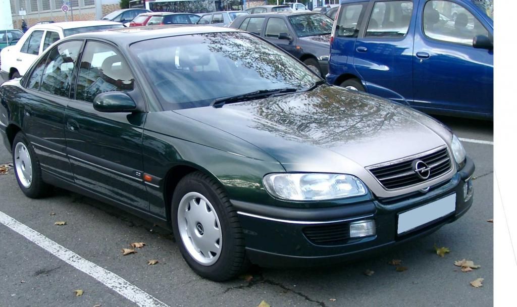

Just a rough photoshop, but here's the gap you'd find between bumper and a facelift bonnet

« Reply #5 on: 17 December 2014, 13:19:21 »
Isn't that an air intake?  ;D
