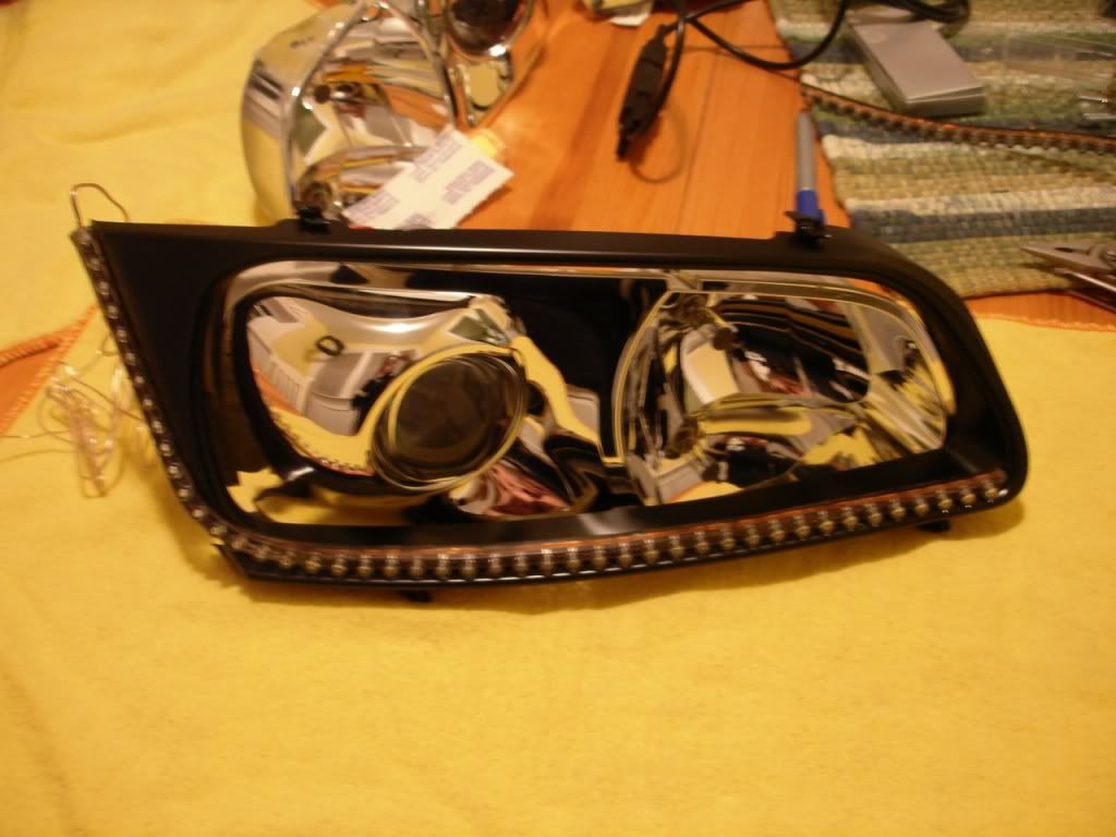

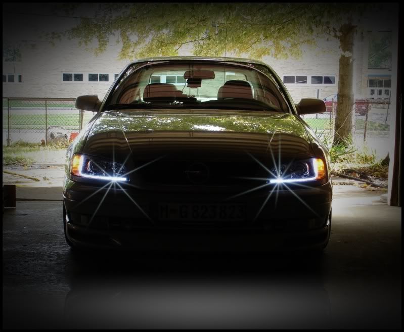

I remember there being pictures posted ages back of a Catera who's owner (can't now remember who) had fitted leds in the bottom of his headlamps ala Audi do

« Reply #22 on: 18 February 2015, 22:46:33 »
is a white catera, full spoiler kit, dark lense and  looks like full HID Lights, not the projector lights / hid  my omega has, with led's going on the bottom up on the side dividing indicators from it.
indicator yellow ledes.
very strange assemble but looks cool.
the lights looking a bit blue while on. so expect fully hid 6000k or above.
plus the round element what bmw has is in them too, which can be switched as sidelights.
still trying to find any info so i may find out who made them.
The owner was CateraMV6. I say was because he has since sold the car. If I find a thread showing the installation of the LEDs I'll post the link.
PS: Don't let the plate or Opel badge fool you. His goal was to return his Catera to its Omega roots.

« Reply #24 on: 19 February 2015, 15:09:23 »
thats looks similar. :D

Not exactly a step by step tutorial but there are really good pictures of the LEDs.
http://cateraowners.forumotion.com/t115-2k1-ccs-retrofit-w-fx-r-50w-ddm-dl50-r8-led#424

That link is a practically definitive description of how to modify the Omega headlights. Good find  :y

this looks similar, but how would the round led's over the bulbs fit without influence the actually low or high beam lights?
the one i seen have them leds like that, low beam /  high beam and over the actually bulbs round ones attached.
the one you usualy see on the bmw's.
i guess that's selfmade ones too then.
in the case above, the lights need to be taken apart to do it, where the problem comes onto it -
not easy. ha ha  :-\
the one above looking good, but i think my tinkering experience with that is not good enough. to go on the risk of damaging the whole light. ha ha
and also out of experience - them led's don't hold long, so after maybe 2-3 month the will need to be replaced which is too much hassle.
