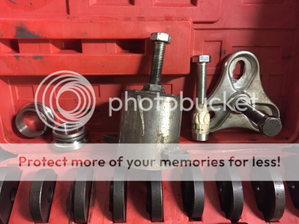

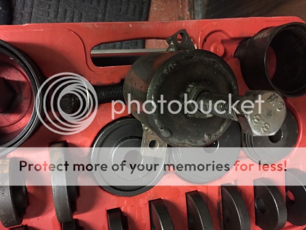

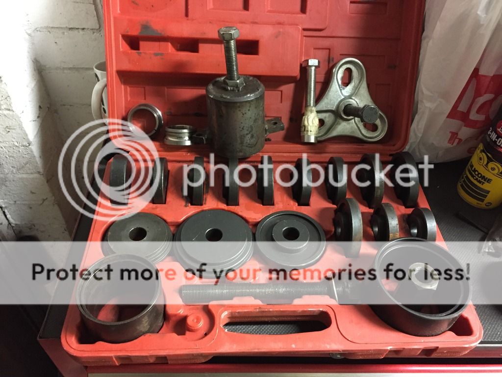

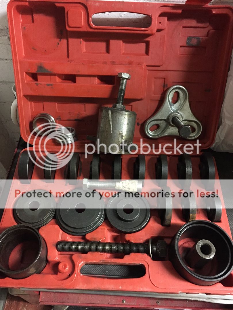

An explanation of the bits is in order.
The boxed set is a generic wheel bearing set, bought off EBay for about £40. Sealey have a very similar set but it is much more expensive.
The tools resting against the lid, from right to left are: mini flywheel puller with one of the slots filed out to remove the drive flange; the tubular tool bolts on the back of semi trailing arm through the brake backing-plate holes and pushes the hub out of the bearing; next to that are two inner bearing races bored out to loosely fit over the hub as spacers to pull the hub into the new bearing.
These tools look shit as they were cobbled together on the car using 'scrapbinium', but enable the removal and refitting of the hub and bearing in less time/hassle than removing the arm and using a press.
I do have a drawing for a better hub tool, but need the measurements of the backing plate bolt holes to make it.

The tooling shown does the same job as the press.
But you have to remove the entire semi-trailing arm to get it in the press, find suitable packers, and hold the heavy assembly while you do the job.
I have a press, and even bodging the tooling(as you can see it is VERY rough) was less work. And that was just the first time I used it. It's not like Range-Rover radius arms, which are removable by undoing two bolts, and often need considerable pressure for some time to release the bush.
I've been thinking about this, and reckon a better made tool could remove the hub and do double duty removing and refitting the bearing. Which would make a good kit for the job.

 I pull it back through with the hub nut and a couple of old inner bearing races  modified as spacers. One just has the wide slot I cut in it to get it off the hub so it is now a loose fit, and the other I bored out in the lathe to be a very loose fit.
A cordless impact wrench makes light work of doing these jobs.
