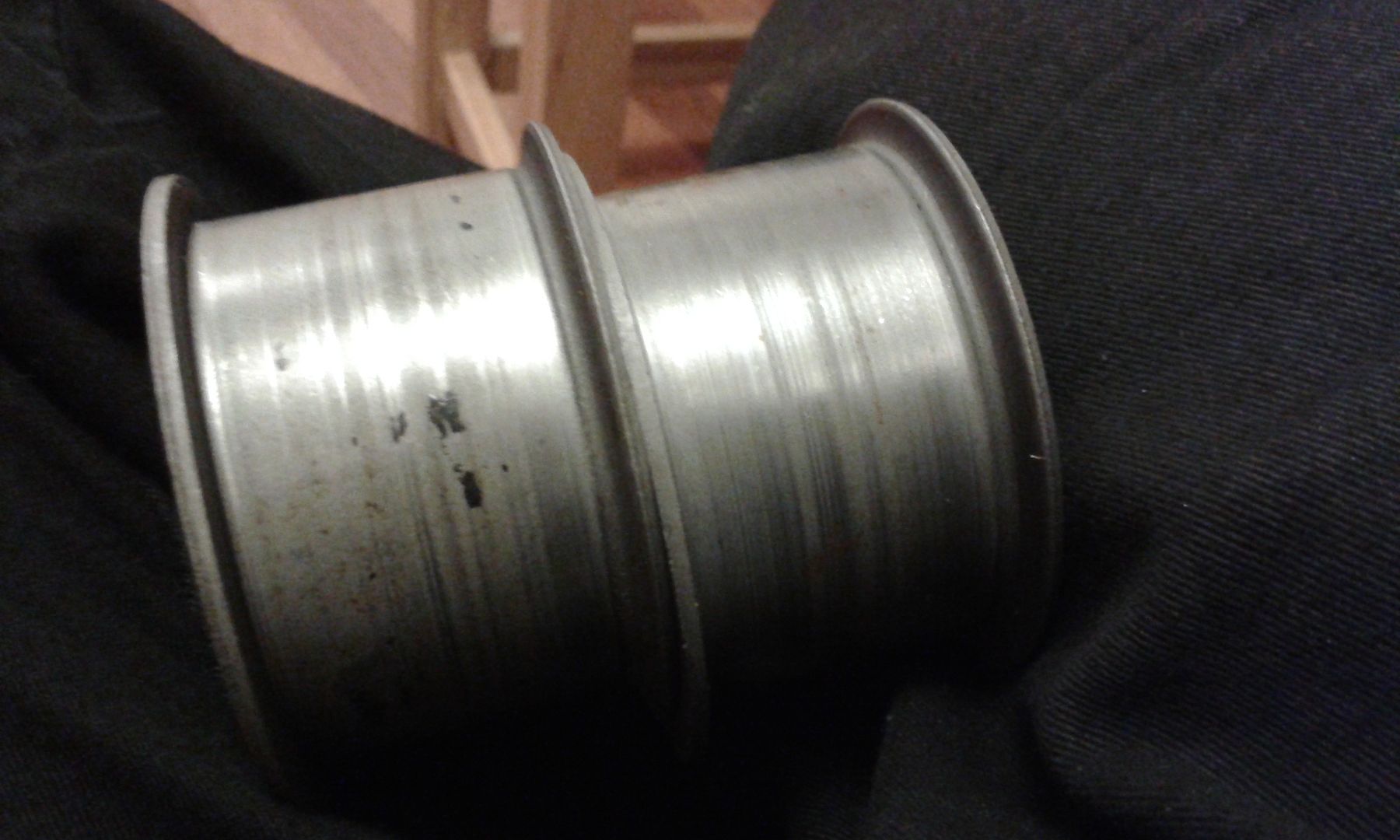

....and a pic of the bits of baked on belt in comparison with the other one. its like this all around the pulley  :y
RIP Paul Lovejoy
I wonder if that is from the old belt.  I have noticed when a belt rubs or gets damaged on the outer edge the bits accumulate by the bottom pulley.  If left behind it would be easy for some to fall on to it and then be pressed on to the metal.  That may explain the squeeking but not the clicking.
