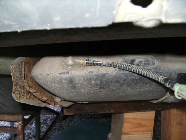

This was just the start of my problems. Inspecting underneath I saw that there are a number of approx 8mm pipes connecting different parts of the tank. Unfortunately, when the LPG was installed the gas pipework and electrics was run in such a way that a run of the 8mm pipe I describe above is trapped by the LPG pipework. This makes removal of the tank impossible unless it is possible to disconnect either the LPG pipework or preferably the union of the petrol pipework. Here is a picture of the kind of union I need to undo. The actual one is at the front of the tank where I am struggling to get a decent picture:
I will need to remove the pipe at the union of the petrol tank.

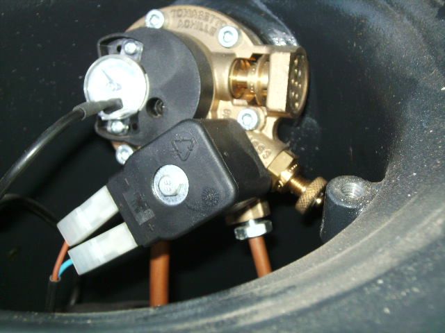

Alternatively, I need to undo the LPG pipework at the tank so that I can bend it to allow removal:
It is the right hand copper pipe that will need to be disconnected. How do I go about turning off the gas so that this can be undone. Do I simply screw up the tap above it? System is a STAG.

I would try to remove the pipe from the tank, as that copper LPG pipework won't take kindly to too much flexing. If you have the cut the pipe off you can always replace it with suitably sized rubber fuel hose and jubilee clips. I think these connections are just breathers to both ends of the tank to ensure it fills properly.

Disconnect the wires and the tank is shut off. Additionally turning that knurled knob as a backup.
That copper pipe will probably need replacing... You can get a joiner to save running it all the way to the front :y

I have removed the tank by snipping the vent pipe that was trapped. Looks a simple repair when I put it all back with a 6MM straight connector.

Got the next problem tho. The venting pipe that I had to cut is 6mm internal but made of plastic rather than rubber and is corrugated/ ridged. I bought a plastic connector and will need to warm the pipe in order to get it in. However I'm concerned this may not make a good enough seal even with a petrol pipe clip around it.
I'm wondering whether I should try to replace the whole length with rubber hose if I can get it onto the tank unions.
Anybody and suggestions?
I haven't had to repair that hose but have joined similar sounding hoses (a long time ago) by 'boiling' the ends in a kettle and then ramming in the biggest hose joiner I could conceivably get in there; when everything cooled it was a nice, tight fit. Granted this was for vac & boost rather than fuel vapour  :-\ but if you've any doubts I don't think I'd worry about replacing the whole run with rubber and clips.

I use a heat gun for fitting nylon pipe as I didn't have any luck with boiling water. This was to make fuel injection pipes, and I never had any issues.

I was concerned that the corrugation would prevent a good seal on the 6mm connector and obtaining a suitably small securing clip.
What I have done is cut back to the unions where the corrugation smoothes out. Then I have forced some 10mm fuel hose over and jubilee clipped. Seems a  good repair. :)
