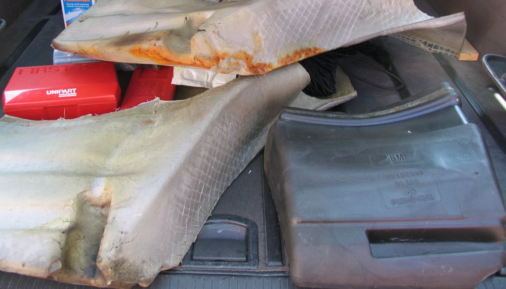

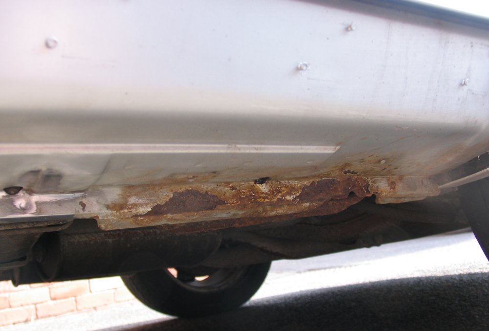

Corrosion is the C word when it comes to any vehicle made of metal, as eventually Mother Nature tries to reclaim all the minerals that went into its making. I've been fortunate(?) in having an Omega Estate on the driveway for the last 4 years, slowly plodding my way through it from front to back, and being amazed at the amount of surface corrosion that is found behind various bits of panel and trim.... and an example that I thought was relatively tidy when I started on this venture, and I haven't even had the door cards off yet.
There's no doubt that any car which has endured several British winters in its early years, will have started to rot away from the inside, and the whole chemical process of oxidisation may even have started as early as when the car left the factory! The areas around spot-welds are particularly prone to early signs, and when you get into the depths of Concentration Cell Corrosion it becomes obvious how the rot starts off due to stresses within the bodyshell and minute cracks forming a convenient channel for oxygen. Once you see the surface rust bubbling away, it's a good indication that there is rot within the confines of the seam joint working its way out. You'll never really get rid of it unless it's cut out and replaced with new metal, but there are several ways to treat it and keep it under control. I'm not promoting any remedial action, just giving a few pointers at this stage.
I haven't started this thread to frighten anyone, but maybe just bring to your attention what I've found. Eventual corrosion when holes start to appear is a sure sign of a scrapper (and not a bad thing when there's still a few knocking about), so always worth spending some time doing simple things like removing the sill covers to see what's lurking behind there. The resultant trap of moisture and grott is a gateway to trouble, so I hope my findings will be of help.

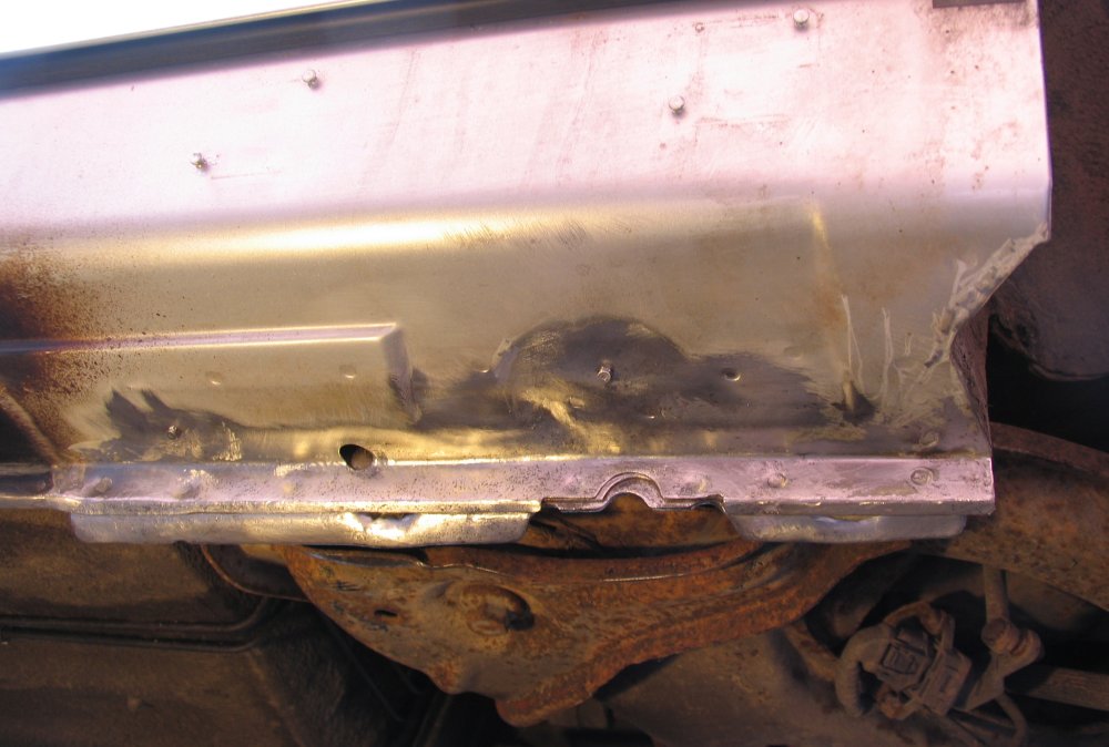

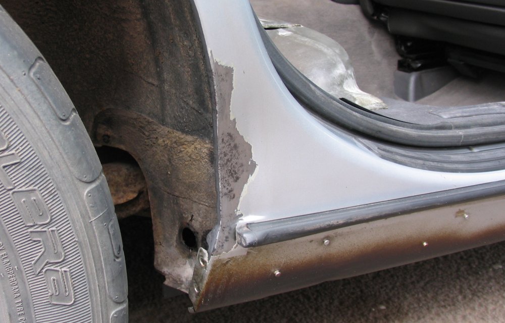

Even after cleaning up on the outside, the rot will still be there on the inside.
The small wheelarch liners can reveal grotty areas when removed, and don't be fooled into thinking a nice patch of underseal isn't hiding anything nasty underneath. The cleaned up area was given a blast of porous primer, and the box sections inside sill squirted with a penetrating oil. After an hour the first dose of Dinnitrol was sprayed liberally inside, and allowed to permeate through the internal parts of the joint, eventually sponging through to the outside. Hopefully it will keep it preserved for another 5 or 6 years.
Condensation will have formed on the inside skin of the bodywork many hundreds of times, and the droplets and moisture will sit down in the crevices keeping the atmosphere damp. I'd estimate a large proportion of the dreaded rear wheelarch rot comes from inside the car, not helped by a few stonechips outside.

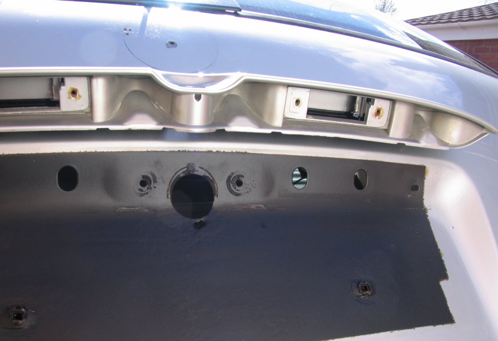

The tailgates on Estates are a well known problem, and started off by poor drainage below the wiper spindle, badge holes, and around the push button.

Nice set of images. A job I'll be attempting soon, I hope  :)

My spare Omega now has a hole in the bottom of the sill, same place as shown above. That's done galactic miles and lived its life as a taxi. Not bad for nearly 20 years, nut it's still a sure sign of what's to come...

That tailgate picture is misleading as that wasn't painted properly... should be painted before being built up... ::)
Also stands to reason that any part which is clipped or bolted to the main panels/shell has the potential to rub to paint and primer away allowing corrosion to begin :y

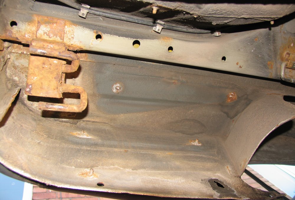

This project Omega seems to be never ending, and it's a close call as to how far to take things...... removed rear exhaust section this afternoon to get in behind the nearside rear valence to inspect and tidy up. As expected, a couple of heat shield studs sheared off, but fortunately they were on the top shield which I can drill and fit nuts / bolts from within the loadspace area.
Found my first hole on the old girl, on the nearside inside rear valence, in an area where a shield stud should have been.
And previously found this when the bumper was removed.
I know...... I must be mad, but find it therapeutic sorting out the grotty areas.

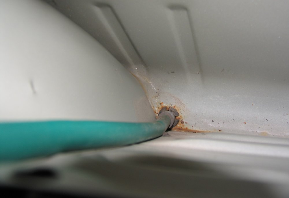

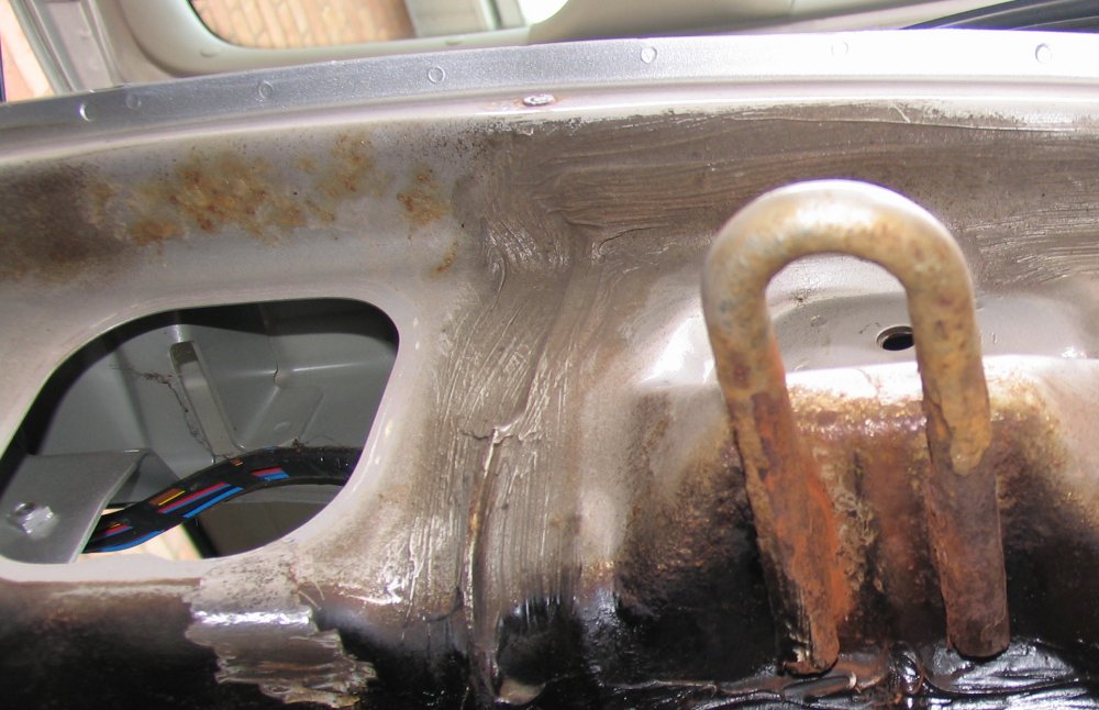

Inside the rear valence area, hidden by the rubber pockets that sit inside the cubby holes.
This shows where the sunroof drain pipes eventually come out, and the rubber bung / socket area is starting to suffer from surface rust.
After removal of the rubber pockets (I don't know if this is the same on the saloon versions), it was found to be dripping wet, and it hasn't rained here for over 10 days. It's pretty evident that the foam rubber pockets trap any moisture in this area, as shown by the top one in this image.
