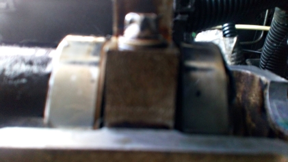

I am refitting the exhaust and inlet cams, Haynes manual says make sure No1 cylinder lobe is up, when I do that timing marks will be out The writeup off this Site for Headgasket replacement says put them at TDC, I cannot get them to stay at TDC. I never removed cam sprockets so they are correct. Also removed cams one at a time, along with carriers, and wrapped in seperate marked boxes, so not wrong way round. Here is a pic of exhaust Timing mark position now against rocker cover. Could it have something to do with me cleaning out the lifters, they do compress and spring, they also went back into the places they came from. Can anyone see anything I have missed or should it do this? Thanks for any help, it's driving me mad  :'(

Re: Camshaft replacement
« Reply #1 on: 18 January 2019, 12:20:57 »
Is the cam pulley correctly oriented?
I believe that it is possible to refit it 180 degrees out...  :-\
  • Posts: 36533
« Reply #2 on: 18 January 2019, 12:25:56 »
Firstly, make sure the crank is turned back to 90 degrees before the TDC timing mark to ensure you don't damage anything while fitting the cams.
You will need to turn them to the TDC mark and then lock them in place. Do you have the locking tool used for cam belt replacement. If not, I would get one before proceeding further.
Often there are flats on the camshafts that you can place a spanner on in order to hold them in place. The valve spring tension will act on the lobes and cause them to try to move, so maybe get an assistant to slip the locking key in while you hold the two cams in place with a pair of spanners?
If you haven't removed the sprockets, it strikes me that you won't be able to correctly reinstall the camshaft seals?
Once you have the cams locked at the TDC position, then carefully turn the crankshaft up from the 90 degree before TDC position until the TDC mark lines up, then proceed to install the cam belt as you would when changing the belt.

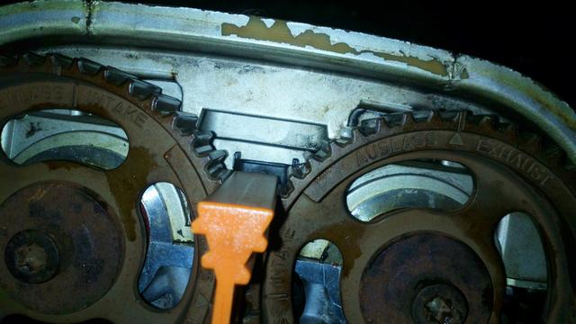

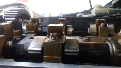

Set the Timing marks up on the cams and locked them. Both No1 EXHAUST AND INLET Lobes look like this, almost level. (EXHAUST are the first two closest to you, inlet are in background)
Do they look OK?
Back two EXHAUST lobes on cam
Timing marks locked in place

  • Posts: 30993
« Reply #9 on: 19 January 2019, 16:48:30 »
What engine is this?
Should have been asked first :-[

  • Posts: 30993
« Reply #11 on: 19 January 2019, 17:07:32 »
Re read the following in Haynes...
Page 2B.9 10, Camshafts and followers - removal, inspection and refitting, Refitting, Paragraphs 9 through 19.
Pay particular attention to the complete paragraphs 10 and 18 :y
