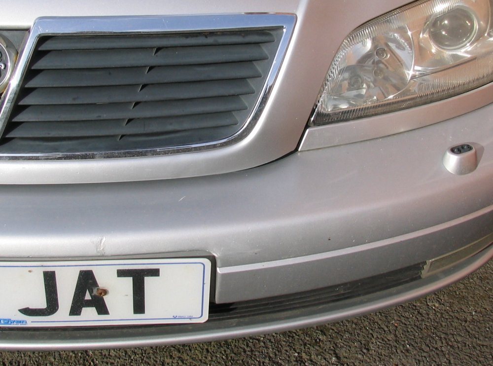

STEMO on form as usual.... only problem being I haven't seen another Omega for nearly 2 years now - must be just a Barnsley thing!
Anyway, I've dried my tears away now and after a couple of hours with a -
Mallet
Block of hardwood
Abrasives
Filler
Wet & dry paper
Rattle can
Looking a bit more like it used to (don't look too closely).

That looks a very reasonable job, certainly saved yourself a few bob.  :y

used with the hardwood block to raise most of the dent, and lower the raised area around it. If you don't do that and just fill the dent, the repair will always show :y
