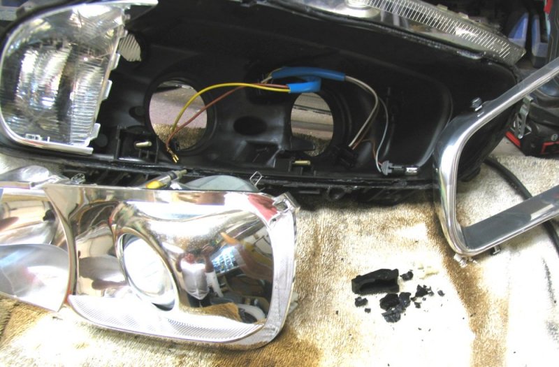

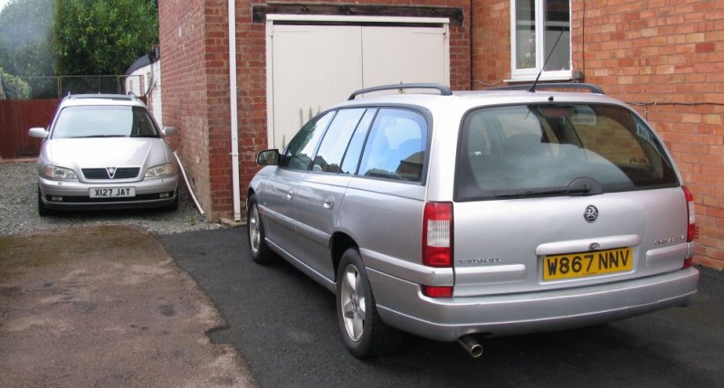

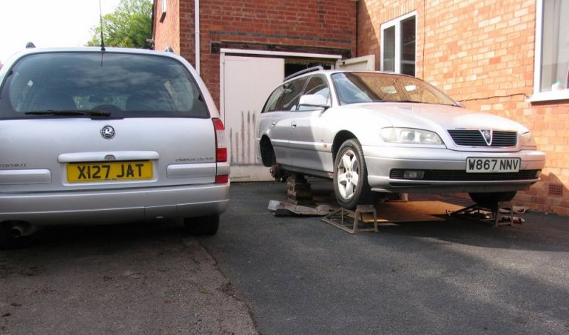

It's good to hear about recent MOT test passes, just like Tony's this week. These two have also been for their test this week, the X reg sailing through with just advisories for rear tyres. The W reg has been off the road for the last 3 years, requiring a lot of work to get it into good order. I very nearly dismantled it for spares, after it collided with a small brick wall and ended up on top of it, causing damage to the wishbones and steering, but after finding there wasn't any penetrative corrosion anywhere, reconsidered and decided to tidy it up. I've covered every inch of it with work to the engine, cambelt kit, rust removal and prevention inside sills, wheel arches and chassis rails, replacement handbrake cable, new wishbones and steering, so after around a spend of £1200 I've got something half decent to run through the winter.
It didn't get a ticket due to headlight aim, but sailed through on everything else bar a couple of tyres.
So this will look familiar no doubt - crumbled headlight adjuster.
After all that work I'm pleased as punch to have the car back up to scratch - there'll be a couple more years left in it yet.  :)

New headlight adjuster fitted at weekend, unit reassembled and fitted back into car. Booked re-test for tomorrow.
I had the dreaded rev counter flicker at zero, with no speedo occur yesterday (fuel & temp gauges ok)  - binacle out and cleaned contacts - all seems okay now.
Fingers crossed, it'll be good to get a few miles under its belt during the coming months

I'm pleased to say the W reg passed its test today - headlight aim not quite spot (but close) due to my improvised bits of tape on the garage door, but at least the tester managed to adjust it this time.
Just got to buy some road tax and enjoy being behind the wheel of this car again after 4 years of it standing on the driveway. She's a bit tatty around the edges but mechanically sound, so will now be the winter car and can change over to the tidy X reg next spring.  :D
