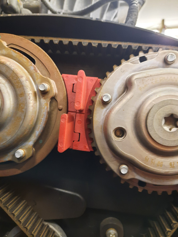

Crank pulley seem removed by taking the big bolt away - not a problem? Left "idler" is propably a tensioner - any rules how to adjust the tension or are there clear marks?
with the flywheel locking tool in,the crank pulley bolt comes out ok(it's very tight ) new bolt required (which is in the gates kit)
yes the left idler is the tensioner  :)  spring loaded/self adjusting  ,holds back with hex key to get the belt on
the original design of tensioner was spring loaded too with a pin to pull ,but that was revised to be bolted in place and wound back with hex key .
the belt is pretty tight to get on even with the tensioner slackened ,but DIY doable ,just take your time ,
DON'T load up the cam phaser sprockets to get the belt to fit ,keep them locked
timing marks are a guide but don't line up perfectly
Gates kit contains instructions ,idler with new bolt ,tensioner with new bolt, belt , crankshaft bolt
it's worth re-packing (with grease) the aux belt tensioner pulley as you would on an omega  :y
Yes, the marks really were not lined up perfectly, job jobbed finally, all ok, (started to think this project a year ago). Thanks a lot for your help.
