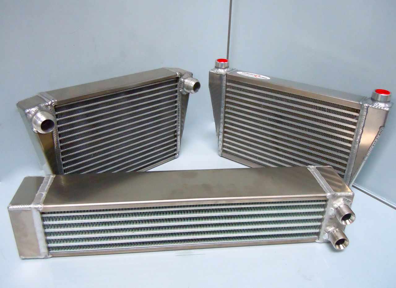

It's all good saying that but who will make one,
https://www.conceptracing.co.uk/image-gallery/oil-coolers/
https://www.motorsportradiators.co.uk/oil-coolers
https://gdmmotorsport.com/product/oil-coolers/
No idea  ;D
A more cost effective alternative would be to find one of similar dimensions and modify the bracketry so that it fits in place of the original.
These folks will even sell you some shiny new hoses to connect it to the block.
https://www.goodridge.co.uk/collections/oil-coolers
