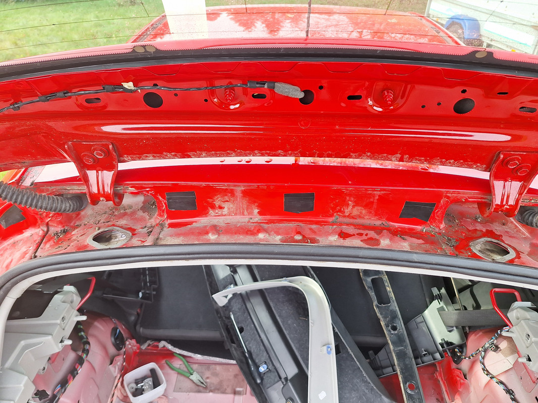

« Reply #11 on: 13 October 2024, 17:44:43 »
Old case but want to report as I believe that I am now in the right track. So everything possible checked, decided to dismantle everything from the boot and finally found that water is coming in through the back corners of the roof (cealing) flowing to those plastic pieces above seat belt coils (you really can see in the first pic that the plastic piece is full of water) and the flowing to boot. Root cause seems to be those oval openings which are sealed with a plastic covers. Took covers away and found wet cealing and clear marks that water has flown down. Put hose covers back with 1kg silicon and hoping now the best.

« Reply #13 on: 30 October 2024, 15:38:41 »
Sure, still minor amount of water from left corner after having sealed the oval openings with transparent Loctite silicon (blue arrow). Then I sealed all the rest seams (around) marked by black arrows on left and right corner, too. Now after hard rain(s) everywhere is dry. I think it is now over. Figure below is from left corner.
