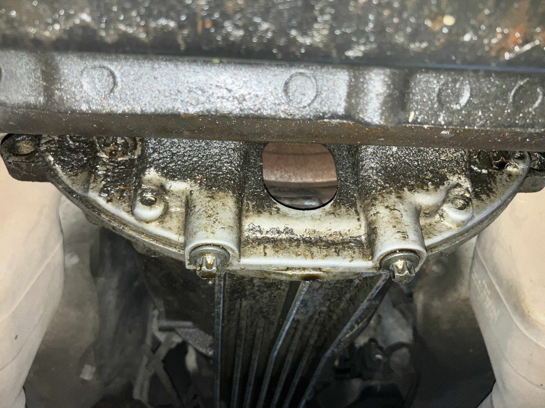

Is it okay to have a hole in the transmission?
« on: 15 June 2025, 19:58:43 »
yeah is oily a little bit. that hole is normal?
  • Posts: 36537
Re: Is it okay to have a hole in the transmission?
« Reply #1 on: 15 June 2025, 23:11:34 »
That hole should normally have a rubber grommet in it. It's the access hole for the torque converter bolts. It won't do any great harm, but might be worth getting a new grommet in case you get any gravel or other contaminants in the bellhousing.
