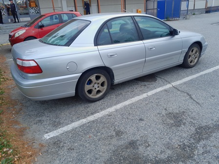

Summer is turning to fall, so it was time to end summer driving season 2025 for this one :)
Couple still shots from the last week behind the wheel and from the video posted earlier.
For the next season Iīm still planning that manual conversion, cause I think this cars needs 5 gears and clutch ;)  Allthough I certainly had fun with autobox as well 8)
« Last Edit: 14 September 2025, 15:27:23 by RallyArde »
