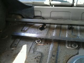

Another quick question.  When fitting the bars to hold the tank could I replace the towbar bolts with longer ones and use them to affix one of the bars:
  • Posts: 36537
Re: lpg tank angle
« Reply #3 on: 10 August 2011, 15:02:33 »
I don't see why you shouldn't use the towbar bolts from a practical point of view. There's probably enough metal under them to cover the requirement for a spreader plate and, in any case, they are hardly likely to pull through the rear crossmember.  ;D
EDIT: if the bars are hollow, though, you'll need a spacer in the centre of them to allow the bolts to be torqued up well without crushing them.

I rotated mine fraction more than this photo shows, I now get slight over-fill of 74L in a 90L tank:

Cheers for the advice Kevin and Mark.
The tank is in now, it may have too much heel but I will deal with that when it comes to filling up.  I didn't use any spacers but mnaged to torque the bars up with one not bending at all and the other only slightly.
