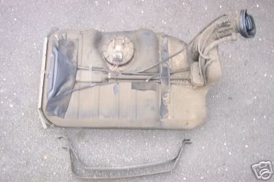

Piccy nabbed from net
The piccy above shows the circular piece I'm assuming is the petrol pump and to my understanding petrol was running down the back of the tank directly behind the pump itself.
I'm guessing the circular peice twists off would reseating be worth ago.
Would you go with Vx on what they say a new tanks needed, they even suggested I book it in for them to investigate, my thoughts were no chance.
« Last Edit: 06 February 2007, 11:44:29 by nixoro »

« Reply #12 on: 06 February 2007, 11:54:38 »
Have you recieved the parts yet from autovaux bestseany :question
No, I haven't had the bits yet mate. I should call them later and chase it up really, as I can't put more than £30 of petrol in at the moment.
I wanted to change the whole metal circle plate and the gasket for it. With it being so badly corroded, I thought it might be possible that it's leaking because of that. The petrol pump connects to the underneath of the metal plate as the plate as a bracket that holds it in place.
My leak comes from the front edge of the tank (facing the engine) directly in the middle.

« Reply #13 on: 06 February 2007, 12:02:39 »
Sounds to me exactly the same problem and seeping from the same place as yours, I shall have to give autovaux a call myself as they obviously know more than my local vx parts department peeps.
