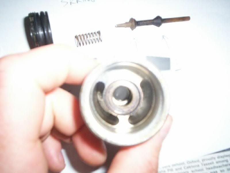

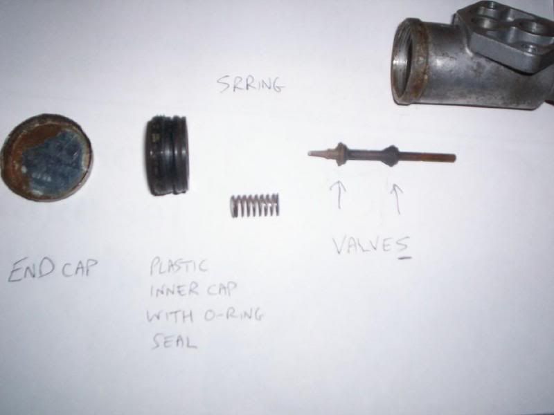

Abiton
Re: help idle problem
« Reply #10 on: 19 July 2007, 18:10:35 »
I've got one of them there idle valves with the endcap removed showing the hidden drillings Grumpy's described, and the second valve that hides up the far end, letting air go the other way presumably to balance any tendency for the valves to be held open by the airflow.  I'll take some photos now (hard to describe in words!).  Would someone with the necessary savvy please PM me their e-mail address and volunteer to post the pics? (If this would be useful).
P.S. If the cleanout of breathers, idle valve etc seems to make matters worse, or no better, suspect a problem with the CTS, that high revving approaching junctions sounds awfully familiar.
« Last Edit: 19 July 2007, 18:23:08 by Abiton »

Grumpy
  • Manchester
  • Posts: 645
« Reply #12 on: 19 July 2007, 19:44:19 »
Here are 2 of the pics kindly e-mailed by Abiton.
The first one shows the IACV broken down into it's composite parts.
Note the valve that you normally can't see towards the Flat end of
the IACV.
The second pic shows the drillings I was talking about supplying Intake air
to this valve.
When the engine is idling with the Butterfly closed, the inlet side of the IACV
is above the Butterfly and the Outlet side of the IACV is below the Butterfly.
Therefore, because of the drillings, each end of the dual valve that you see
in the first pic is connected to ambiant inlet air pressure.
The centre (outlet area) between the valves is subject to the lower vacuum
pressure generated by the 'Suction' of the engine.
The arrangement of the valves, valve differential areas and bleed area, will control
the airflow to the engine and thus the idle speed.
If you get oil down the drillings it will disrupt the correct operation of the valve and
therefore the engine idle speed.
You can see now why I said to soak it overnight and not to oil the valve area after
cleaning.
Thanks again for the pics, Abiton.
