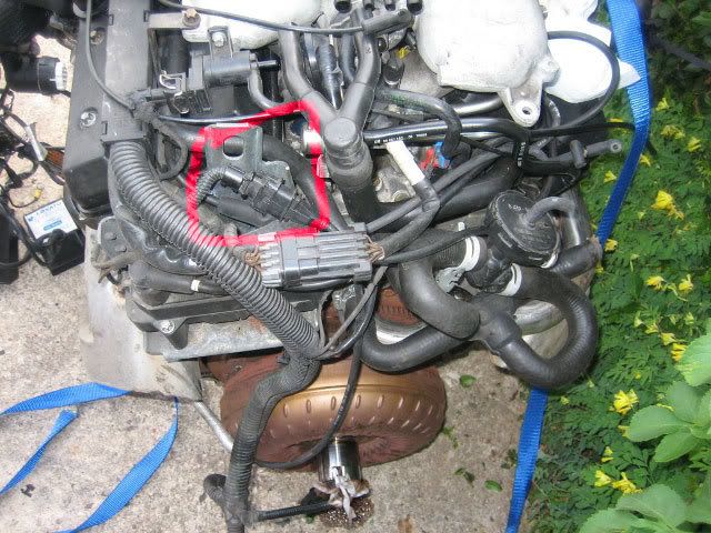

Well the crank sensor is quite an easy job.
Marks excellent guide is here: http://www.omegaowners.com/forum/YaBB.pl?num=1174321688
And this is a picture of the crank sensor and its location.
The Administrator.
Well, that shows its plug anyway :P
The sensor is near oil filter.
Laidback, Thanks a lot for the pic its nice to see the location of the plug, i had no idea what i was looking for :y
