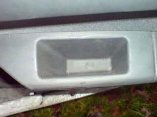

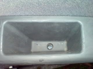

Found it  ;D  ;D  ;D  ;D
In the bottom of the grab handle/cup thingy theres a gromet that needs to be removed and theres a screw underneath. Not easy to get the gromet out without damageing it though.
I'll post some pics of the gromet location and screw later  :y
Thanks everyone  ;)

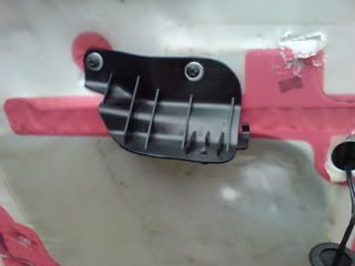

« Reply #8 on: 20 January 2008, 21:06:43 »
Right, i managed to get the doorcard off eventually. I had missed the screw at the bottom of the grab handle/cup type thingy  :-[

Sorry pics are a bit big but you get the general idea  ;D
