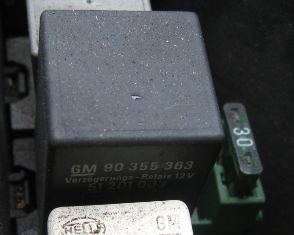

Just fitted the washer bottle with the extra pumps to operate my headlamp washers, now I need to know what the part no. for the black relay in the fusebox under the bonnet is.
I have 3 possible candidates here:
 90 355 363 (1 pin less than the following 2)
 90 069 864
 90 459 301
If possible can someone with an elite please look in their fusebox and compare these numbers to see if any match, and if not please tell me the correct numbers?
thanks v much
Steve
P.s.
Its the black relay with the green 30amp fuse beside it.

Ok.. all 3 of those dont work, at least not as they should
the first one does nothing,
the second one makes the pump run all the time
the 3rd one makes the pump run constantly when the lights are on, regardless of using the wash wipe stalk.

Hi, the relay should be in the compartment under the bonnet next to the battery, it should be the only black one nearest the front of the car with a small green holder and a 30amp fuse in it.
I dont think the wiper one will be the same as thats an intermittent relay.

« Reply #5 on: 07 July 2008, 14:34:12 »
Hang on, I'll brave the rain....
  • Posts: 108090
Re: Headlamp washer relay (please?)
« Reply #6 on: 07 July 2008, 14:41:30 »
90 355 363
Which is first you posted
« Last Edit: 07 July 2008, 14:43:53 by TheBoy »

Thanks v much, seems that maybe the relay I have here is duff, but know where to get another one.
cheers for your help  :y
