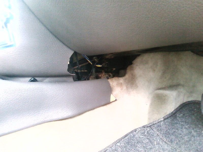

Been out and taken the section I cut out away so you can see where to cut
To be honest - you still can't see the hole unless your head is in the well

« Reply #6 on: 29 August 2008, 16:23:18 »
How did you remove the matrix from that small area (or did you just change the seals?)

« Reply #7 on: 29 August 2008, 16:25:33 »
Using a little force, it comes out, though you need take the fuse box cover off as well

« Reply #8 on: 29 August 2008, 16:30:24 »
There must be different cores or locations or summat, could never have got mine out of a place that small...
I have to cut out at least twice that size just to see the core??
