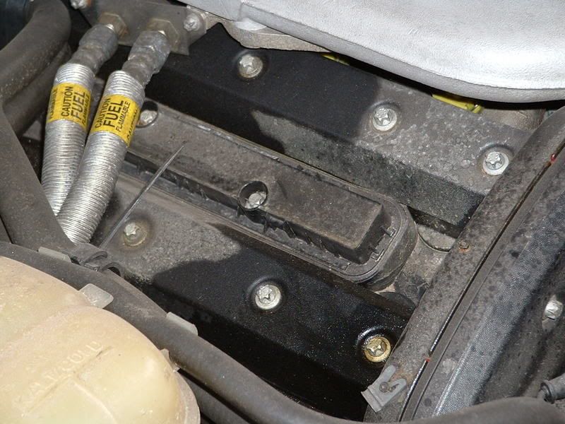

I had my covers leaking and didn't cotton on to the early warning signs that the breather system was blocked with the staining:
