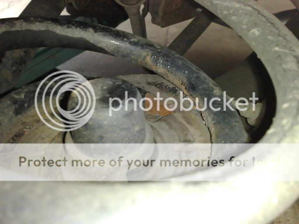

Re: "Clunks" from the rear (right hand side)
« Reply #18 on: 15 October 2008, 09:10:16 »
these where taken with the wheel off
« Reply #19 on: 15 October 2008, 09:31:31 »
I see your point, but I changed the springs without any success...
