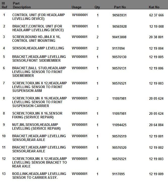

Have a look at this diagram for details of the suspension level sensors found on nearside front and rear suspension.
Check that item 13 has not popped off...........
Part numbers for reference..................

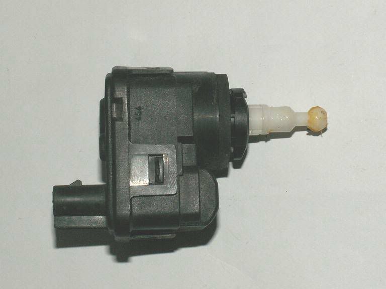

Check if one or both headlights are dropping to it's lowest position, if only one then you probably have a faulty headlamp motor, pics below.......
This is the motor which is a bayonet fit..........
This is where it is located on the rear of the headlight

And it just twists and pulls out  :y
Worst case scenario, the adjusters broken...
