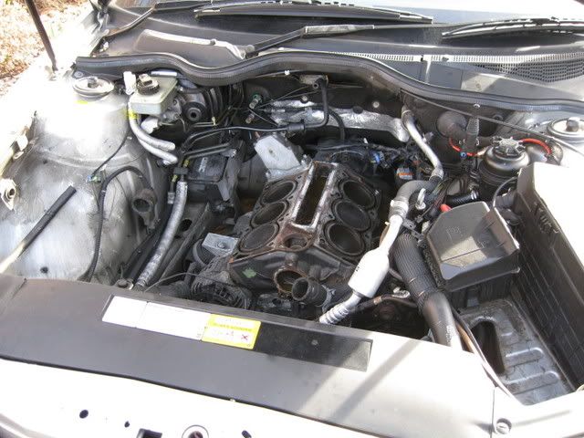

If you remove a few bits off the V6 then access to everything is very easy....look:
very good Mark ;D ;D ;D ;D ;D ;D ;D ;D ;D ;D :y :y
Yes gone are the days when all you had to do was open the bonnet and plugs, distributor, carburetor, oil filter, even rockers, etc, was all there for the taking!! :D :D ;)
Where's my Cortina?? ;D ;D ;)
« Last Edit: 16 April 2009, 14:37:40 by Lizzie_Zoom »
How do you remove the metal pipe above the manifold on the drivers side?
