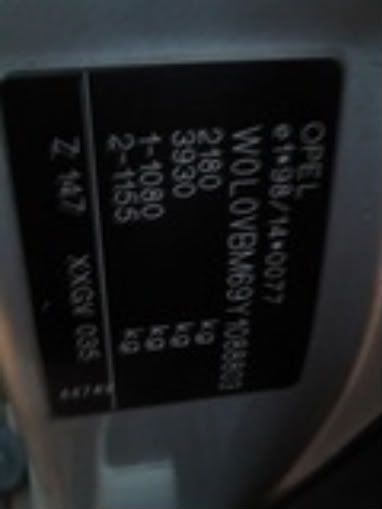

hi guys, ive read the link in the FAQs about reading the paint code but mine doesnt seem to correspond. the below is a pic from the drivers door lock area. whats my paint code?

z147 silver.Halfords paint is shite imo. Btter off getting it mixed at a local paint factor. Its always very difficult to blend perfectly anyway, your car has been subjected to years of exposure to the elements, b ut the paint coming from the can hasnt.you can buy an aerosol from factors called blend, which you spray around the edges of the area you have just painted. It helps it blend with the surrounding area. :y
