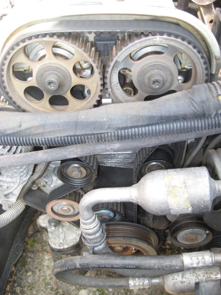

Just doing the gasket now, at the start of the job.  Just putting Cyl 1 at TDC and noticed the timing marks on the sprockets and crank aren't exactly lined up or at least it looks that way?
I've attached a pic if anyone can confirm either fine or not?  The engine ran fine prior to staqrting the job...
Thanks guys
p.s.  Also, on the right sprocket it has inlet and exhaust stamped on it whereas the sprocket on the left doesn't.  Now with both marks lined up the right sprocket has exhaust mark at the top.  Suppose this is right also else the engine wouldn't run eh?

Yes, thats right.
The crank could be 1 tooth out and still run, just not well.
Set the crank 90deg before TDC to get the psitons half way up/down the bores before pulling the belt (for a head off job) as there will be no valve issues then

4 toothbelt's anticlockwise I believe :-?
