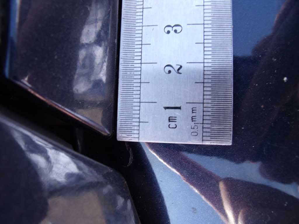

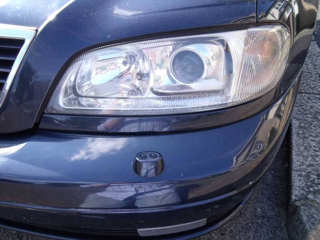

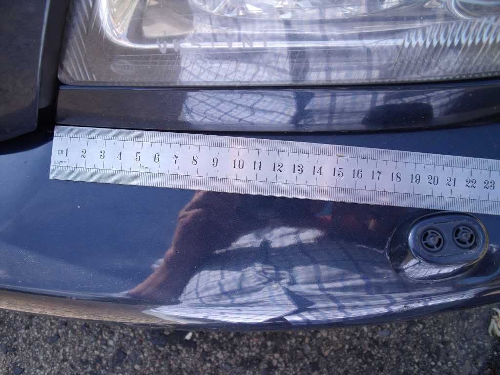

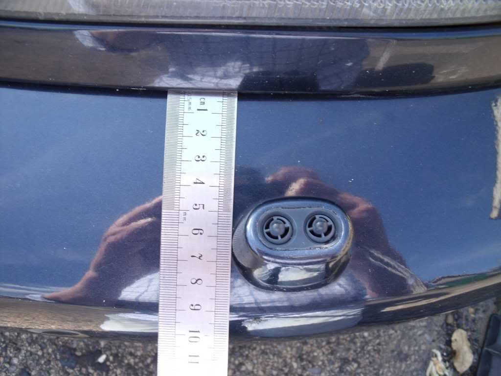

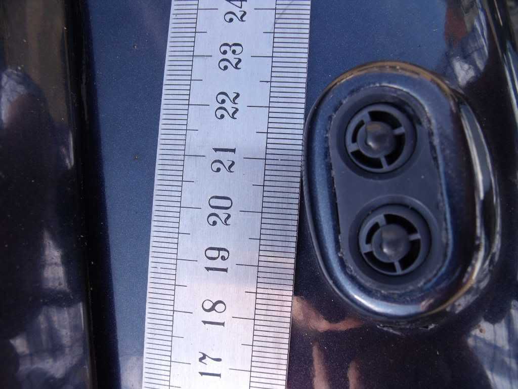

In a word, no.  At least not easily due to the curviness of everything.
Photos including a ruler may help.  Left as links as the photos are quite large.
http://i1006.photobucket.com/albums/af181/astclair2/Omega/Washeroverview.jpg
http://i1006.photobucket.com/albums/af181/astclair2/Omega/Washerforeandaft.jpg
http://i1006.photobucket.com/albums/af181/astclair2/Omega/Washerlefttoright.jpg
Front to back, the washer is about as far forward as it can be whilst remaining on the flatish part of the bumper.  In the photo, the ruler is hooked just one or two mm under the headlight trim.
Left to right, its inboard edge is about 5mm further outboard than the inboard edge of the front fogs below.
Shout if there is any problem with the pics, or if you would like more taken from different angles.
