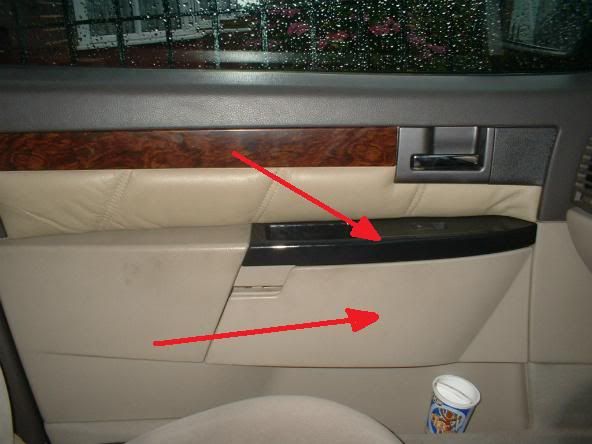

« Reply #7 on: 23 September 2011, 21:17:59 »
Just need to know if the 2 parts (Arrowed) are removable?????
It'll save me masking up the whole door!!!

« Reply #9 on: 24 September 2011, 08:45:35 »
Yep, everything is fixed to the doorcard with plastic rivets.  If you are taking the doorcard off, it's a good chance to lubricate all moving parts.  :y
