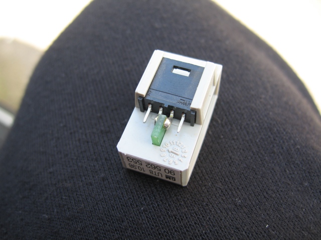

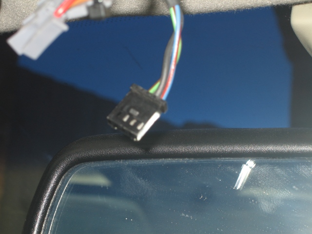

Pic of Mic and wiring.  3 wires, only 2 connected...

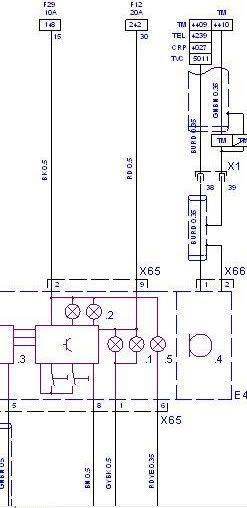

At first glance (I would need to check) that wiring looks different to mine as on mine the black wire (an extension of the cable shield) is connected to an un-used pin.....

The wiring on my bit of Mic loom (from a 1999 car fitted with CCRT700):
Pin1: Blue/Red
Pin2: Black (which looks like sheilding)
Pin3: Green/something
Ping4: N/C
As you can see, my mic is wired to pins 2 and 3.  Wiring diags suggest facelifts (or at least 2002 on) wired across 1 and 2.
Would this suggest a different mic?

Possibly
The above also shows that for a telematics setup that both pins of the mic are wired directly to the telematics unit without grounding any pins!
So ensure this is the case as a first port of call!

To test, I have wired mic up to a short length (6") cable from telematics plug, using the signal pins 1 and 17.  Pin 2 of telematics (shielding) is disconnected.
At normal speech levels, remote party can't hear me if I'm more than 6" from Mic.
My mic is wired across pins 2 and 3 of mic connector, rather than 1 and 2, as my mic has no connection to pin 1.
