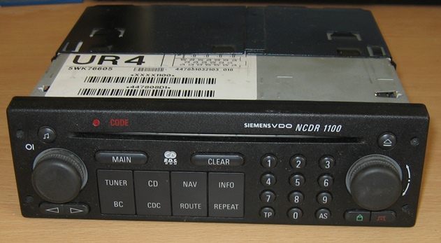

« Reply #6 on: 03 January 2012, 12:51:35 »
Location of fuse...
(Model shown is NCDR1100, but its identical to NCDR1500 in every way except the front bezel)

« Reply #7 on: 03 January 2012, 12:52:58 »
Whats probably troubling for any normal sane person, why did I happen to have a NCDR1100 within arms reach that I could photograph!
