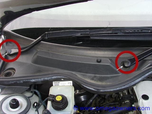

 To remove the wipers, get a small flat screwdriver into the grooves on the caps, indicated here -
You'll see the following 13mm nut - needs a socket and ratchet to remove. A good WD40ing before attempting to shift it is always welcome. Then a quick tap on the end of the ratchet starts the undoing, the nuts aren't particularly tight. This job is a bit if a swine... if you flip the offside wiper off the screen, then grab the stubby horizontal bar and wiggle it off... might be worth levering under with a large screwdriver, taking care not to damage the screen or paint. I, being a brute, just pulled it til it let go.
