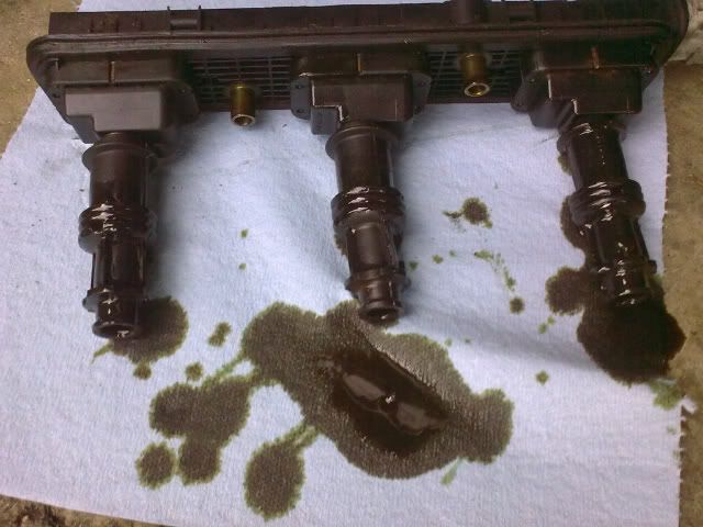

i get it now,all done problems i found,this car had both head gaskets done at 93000 its on 105000 now, and cam belt thermostat cam gasket covers, invoice from last owner £1500 under warrenty and 800 he had to pay. it had different set of plugs normal on left and the four prong ones on right.cam gaskets wher made of silcone passenger side middle plug was hanging out,think this was causing eml to be on,as its off now plugs full of oil,them little washers that go where the screw goes through had different types in their,took me 5 hours went for a test drive got smoke pouring out from somewhere and it sounds like the tappets have gone,not that bad but louder then before,its dark now will have a look friday
Head gaskets done on a 3.2... would not be suprised at a wrong diagnosis there mate. To do the head gaskets the cam covers have to be removed, if the cam covers are leaking which from your coil packs they look like they are the garage where the work was done have not done a great job in my opinion.
As for plugs, the four prong ones are the right plugs for a 2.6 & 3.2.
Smoke pouring out.... If you have fitted new cam cover gaskets you may have not seated them properly in which case oil is finding its way to something hot, or old oil is burning off.

yes passenger side was a pain gasket fell of twice  put dabs of silcone to hold it,will give it a good drive and see what happens,but if i have to redo it its not that bad of a job.

proper black stuff only a few dabs just to hold gasket everytime i put cover upside down gasket fell out,jet washed engine today had long drive and all is ok no leaks,must have been old stuff burning off.
