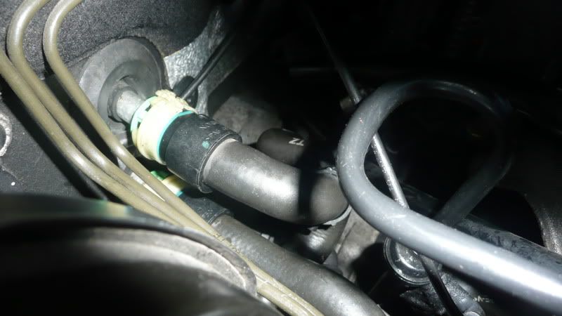

just incase you havent found leak the hbv is 'hidden' down here

Thanks fiend61, I've found it and it's dry. Does anyone know what is the lower part connected/screwed into the radiator? Is it a thermoswitch or something else?
