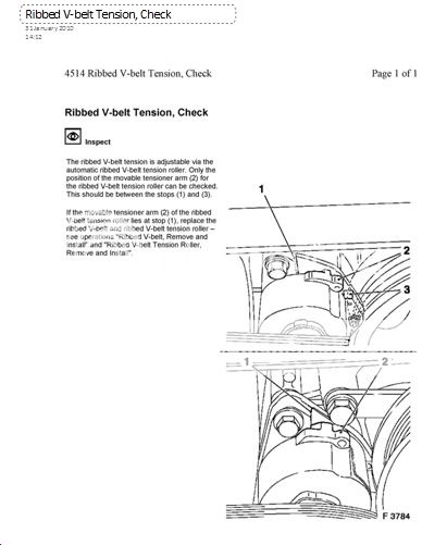

Re: Help - Water Pump
« Reply #9 on: 21 February 2012, 13:53:16 »
Hope this helps :y

Phil, the diagrames were just what i needed, thank you..
